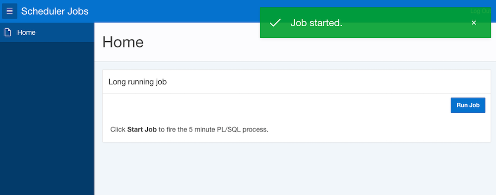

Create an Application Express application and a page within that app. Then create a page process of type PL/SQL using the above code. Create a button on your page (Run Job) and have the page process being executed upon button click. When you run the page and click the button, the result should look as follows.
PL/SQL-Code wurde im Hintergrund gestartet
The PL/SQL code has been fired as a background job

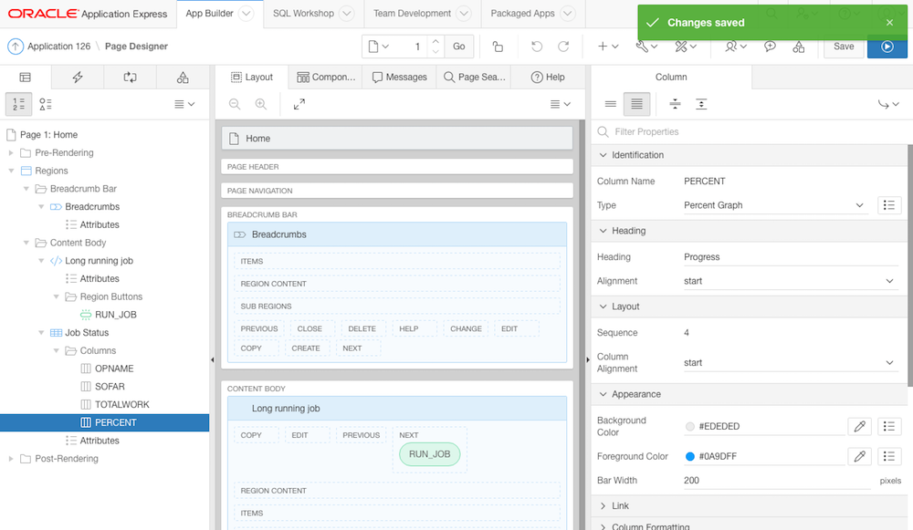

Display job status as a progress bar
Using the above SQL query, we can easily create an APEX report ...
select
  opname,
  sofar,
  totalwork,
  round((sofar / totalwork) * 100) as percent
from v$session_longops
where opname = 'DO_LONGRUN'
and sofar < totalwork
... and for the PERCENT column (which returns a value between 0 and 100), the Percent Graph type is a perfect fit.
Change a report column type to "Percent Graph"
The result should look as in the following screenshot. You might even extend that to have the report automatically refresh using the Timer plug-in from the Application Express Plug-Ins page.
Report job status to the end user with a progress bar
